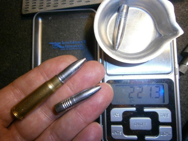

I will figure out a load with H.TiteGroup for this bullet in the 7.62X39 for about 1,000 fps, definitely subsonic, for my Remington Spartan single shot X39 Rooski rifle.
The bullet has a boat tail base that works for low velocity but will also fit a gas check for high velocity. This is an interesting bullet that may get new people into casting! The mold is the new TL309-230-5R from Lee. It casts about 221 grains in my BHN 17 alloy and drops at .3125" diameter which is big enough to size for any of my 30 cal. rifles.

I'm betting these will shoot fine about 1,000 fps and will be great for squirrel. My Single shot X39 has shot better every time I have tried heavier bullets in light loads.
The nose on this bullet is only .300 so I can seat them way out there in my single shot to engage the lands without a magazine to worry about. They look stranger than a 300 Blackout. I am in full hunting season now so these projects are on pause for a bit.

My X39 rifle is a single shot break open, not a bolt rifle. It is the Remington Spartan made by Biakal in Russia and imported by Remington and others.
I have a new scope on it now replacing the cheapo in this photo that came with the rifle. Barrel twist is 1:10 Slugged bore ID G to G is .3098" and chrome lined. I have polished the bore to a hard slick shine and it loves cast bullets.
A better picture of the bullet, you can see it has a tiny flat nose and gas checks fit fine.
