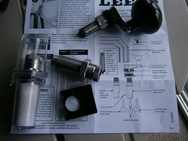

My new Lee stuff:
[URL=http://s30.photobucket.com/user/rhymeswithwhat/media/QuickTrim_zps042dc798.jpg.html]

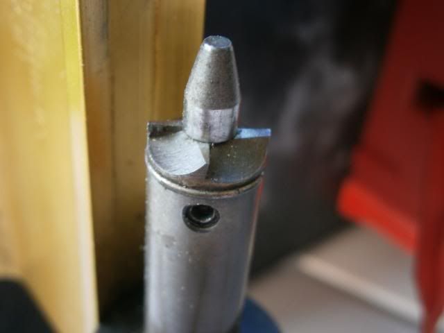

The Lee 4 blade areas of the Quick Trim, the Lee Ball Cutter used with the Zip Trim and the Forster trimmer cutter head are all similar designs made with similar tool steels. These all cut equally fast when doing only length cutting. The Quick trim isn't slowed down with 2 additional 2 additional procedures and performs 3 procedures at once.
So you are convinced that the Lyman will fill your designs, buy 3 Lymans because you will likely be wearing them out the way you expect the others to perform beyond and differently than their design and directions. It is not the tools, You just want what you want. The Forster is commonly recognized as higher quality than the Lyman or Lee. My Forster is back in the box. I'm using the Lee Quick Trim. It is better than the older Lee models or the Forster and it does 3 complete functions simultaneously. The new Lee design evidently has too much common sense for you to understand or appreciate.
Go get your 3 Lymans, you will never be happy with your Lee and you will never get it to work right.
Lee, Lee, and Forster:
[URL=http://s30.photobucket.com/user/rhymeswithwhat/media/P6020151_zps2d242d3d.jpg.html][URL=http://s30.photobucket.com/user/rhymeswithwhat/media/P6020152_zps8105bac5.jpg.html]
