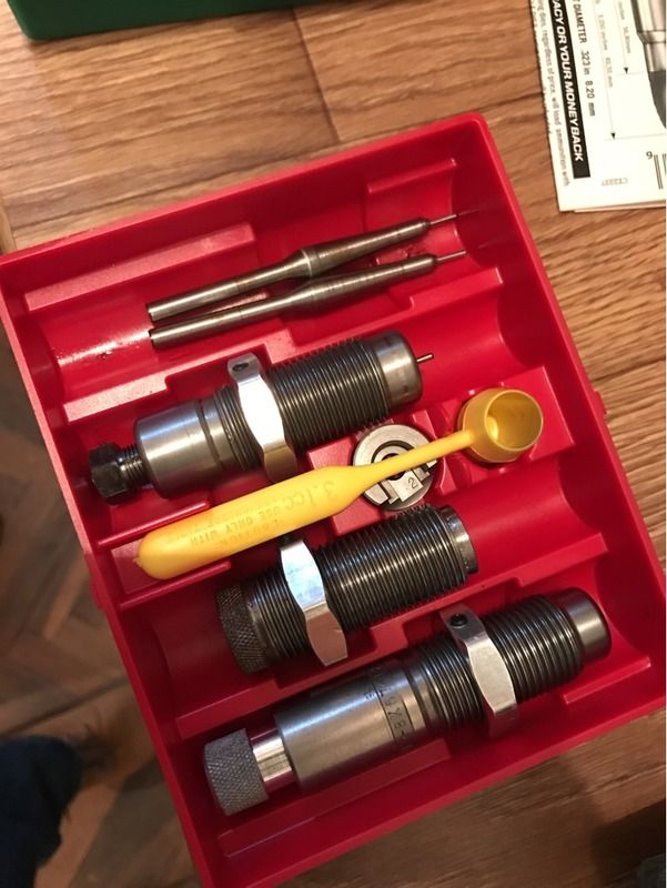

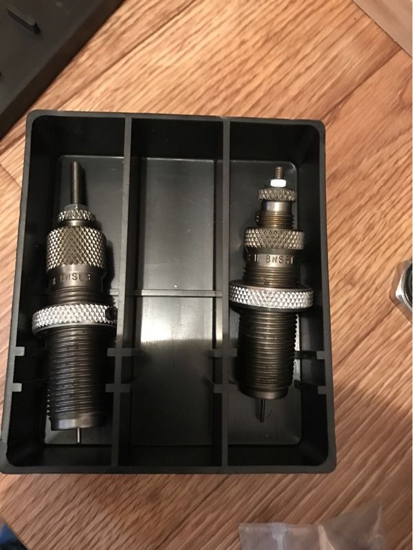

Now, I will use standard Lee set for seating the bullet, and I have CH4D neck sizing die for the job, with interchangeable bushings.

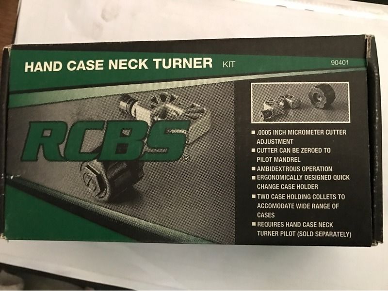

From before, I know there is some catch with using bushings, and that I should neck size in steps, looking at the OD of the brass neck and bulled OD (if I recall correctly). Also, I wonder should I shave the neck with neck turner or should I leave it alone.
I m reloading 8x57 Mauser rounds this time (other CH4D neck die is for 6.5x47).

Neck turning is only called for when you use non standard bullets, non standard chambers or non standard brass. Get the right stuff instead.

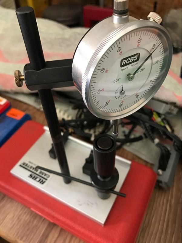

Neck OD of those fired cases, on all of them, was 0.359 (we use metric system here, so I have to recalculate everything lol). All of the measurements were taken by micrometers (inside and outside), with 0.0004 accuracy.
ID of those necks varied, from 0.325 to 0.329.

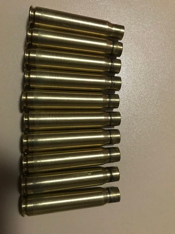

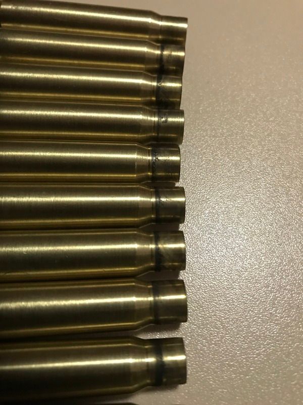

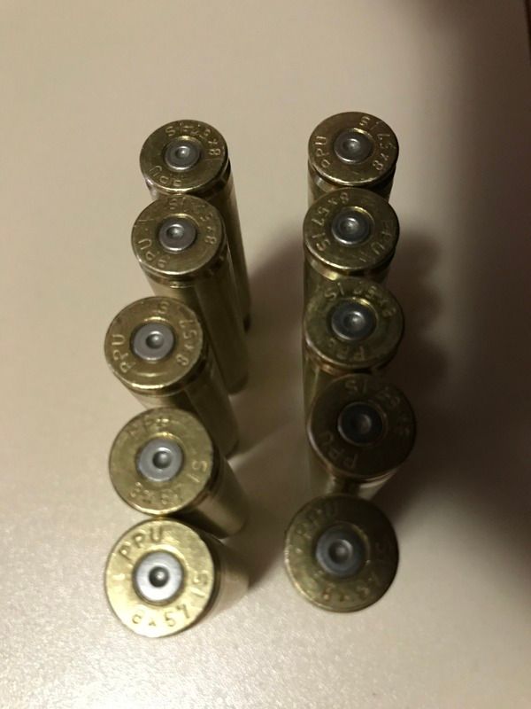

Results on paper were so so (mainly because of my faults), but I got pretty much consistent speeds - 2460 fps +7 and -6 in all 10 samples I made.
The looks of the cases after firing
Edited by - UlicniTrkac on Mar 01 2017 18:10:05
