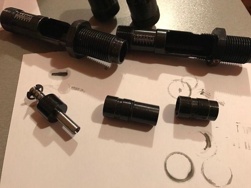

Can you give me a piece of advice? I have a RCBS Gold medal seater die for my 6.5x47 with apropriate bushing, and I have a RCBS Competition seater die for 8 mm. Both bushings fit into one or another die, so I was considering using the 8 mm one in gold medal seater die - is this doable?
9125 Posts
Posted - Mar 05 2017 :  11:58:57  Show Profile Send Shastaboat a Private Message  Reply with Quote
Although I don't use neck sizing bushing dies, I have seen dies and bushings made by different companies and the bushings all fit the various neck sizing dies of their competitors. I've always thought bushings were for sizing and bullet seating stems are for seating. Am I missing something? If you are referring to seating stems and they are both the same thread, there should be no problem changing them.

Posted - Mar 05 2017 :  16:08:53  Show Profile Send UlicniTrkac a Private Message  Reply with Quote
uh, maybe the pic will explain better
9125 Posts
Posted - Mar 05 2017 :  17:06:35  Show Profile Send Shastaboat a Private Message  Reply with Quote
What I thought. You are talking about a micrometer seating die. Not a bushing die which is a sizing die. I bet if you measure the die bodies, they are exactly the same. What you are calling a bushing is the part that designates what caliber you are loading. I guess you can call it a caliber specific bushing that is used for a specific caliber shell length. Also why is the die so oily?

UlicniTrkac
New Member
29 Posts
Posted - Mar 05 2017 :  19:02:45  Show Profile Send UlicniTrkac a Private Message  Reply with Quote
Thank you for pointing this out - English isnt my native, so I can get it wrong some times :)
caliber specific bushing it is :) they are oily because I havent used them at all and I got them 4 years ago, so I went up and oiled/cleaned them.
Bodies are the same, but the seating system isnt (the upper part) both do have micrometers, but one have this c-clip part (gold medal one), and the other doesnt, that one has just the stem that is "one" with micrometer.
Also, caliber specific bushings fit into one another, and I wanted to use the c-clip stem with caliber specific bushing from other die. I believe it is doable, just wanted to check with you fellas about it before trying it out.
9125 Posts
Posted - Mar 06 2017 :  14:54:39  Show Profile Send Shastaboat a Private Message  Reply with Quote

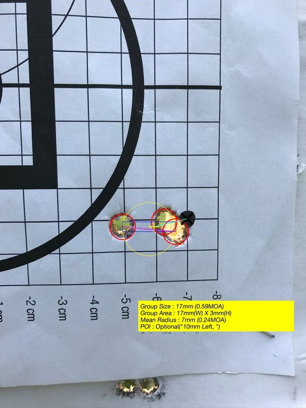

Done some researching with several bullets that I have on hand. I got the Lee collet die for my Mauser, and I am very satisfied with the results that I'm getting with it, for such a low price :)
I used some data that I could find for N140 powder for Accubond, Match king and two PPU (Prvi Partizan) bullets - Accubond and Matchking are 200 grains, and PPU - both PSP BT and HP BT are 175 grains.
I developed the loads, but according to QuickLoad pressures on those most accurate loads were off the roof! In real life, I didnt have no high pressure signs on my cases, nor the sticky bolt at any time. Nevertheless I wont go over these, for safety reasons.

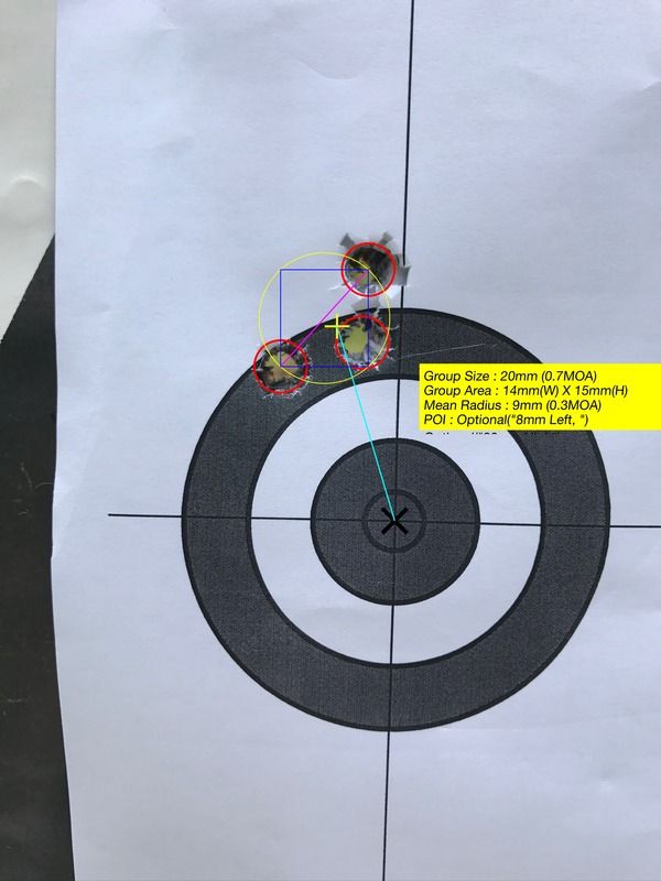

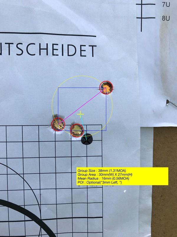

Any way, Accubond got me this result on 100 meters, from shooting rest, with 49,9 grains N140 (oal 81.70 mm - we use metric system, and for oal I always use millimeters, but for powder and bullet weight I use grains)
With Matchking, almost the same load gave best result - 49.8 grains of N140, oal 80 mm

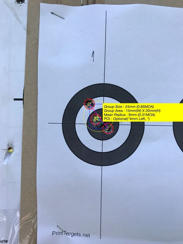

PPU PSP BT - this is my hunting load for now, it is cheap and available, and its more than I need for hunting - with 49.8 grains of N140, oal 77 mm
PPU HP BT - it needs a fine tune, but its close - 49.9 grains, with same oal as PSP - 77 mm
I cant find the paper where I wrote down the speeds measured with Chrony, but these were quite fast. Im not sure is it OK to post the game I hunted in previous weeks here.
Also I had the stock bedded, it really helped with grouping tighter!

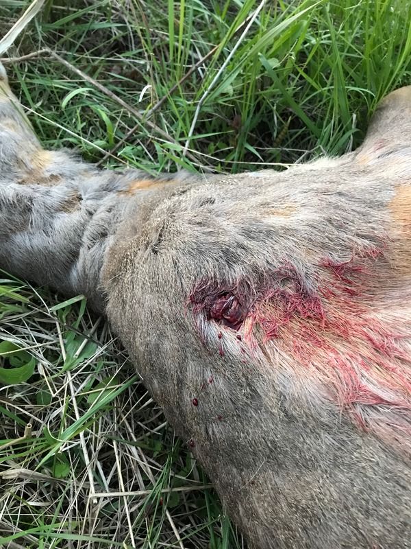

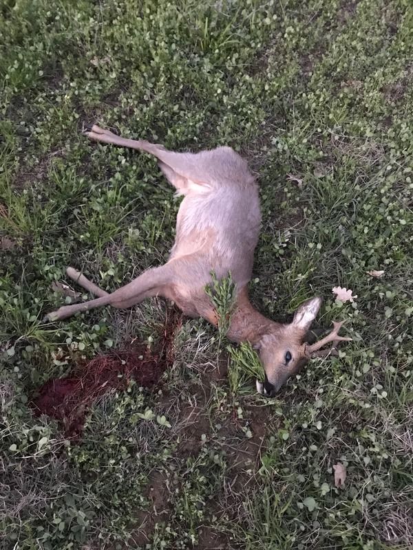

I got three this year. All were shot from 150-180 yards away, first while stalking, second from the stand and third while searching through the fields with a off road wehicle.
First one, I was aiming for a high shoulder, but I placed a shot on the lower neck. Down on the spot (they all are, no movement at all, not even a jump)
exit wound

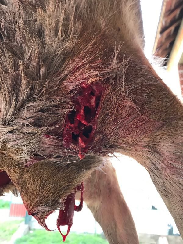

Second one was the furthest, and he got it in the high shoulder. It seems it didnt hit no bones so meat damage was minimal
