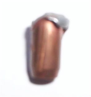

Thanks for all the advise guys. I am going to hijack my own thread. going back to the accubonds. I think they are terrific bullets but not for a .308 win. I have shot 3 different hogs with them last summer and the entrance wound was the same size as the exit wound(always a chase). they are almost like shooting a FMJ bullet. here is one of many bullets I have dug out of my pond dam.
I appologize for the photo was not in focus.. but you get the idea..
