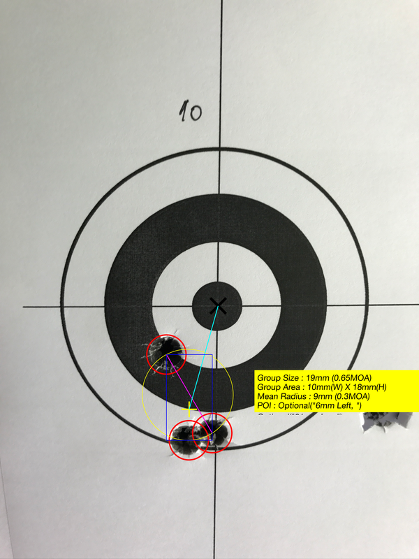

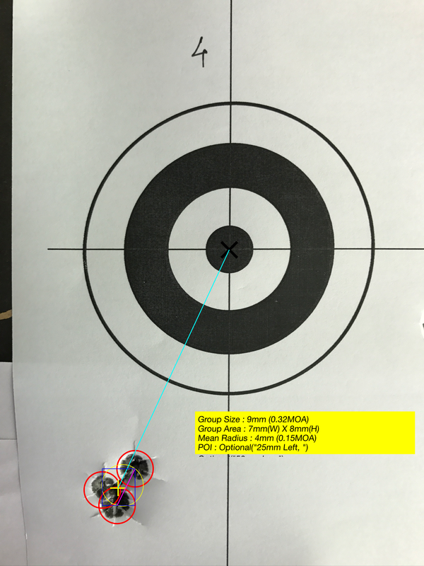

small update on load development, I think I made the Accubond load even better on 100 meters :D
and Hornady SST gave me this (got it quickly)

That's a fine shooting rifle.
Keeping things simple when reloading is more than good enough for the vast majority of intended purposes. Especially for hunting ammunition.
If I was in your boots hunting little deer with the 8mm Mauser, I would stick with the accubond and get trajectory data and just have fun practicing field positions.
